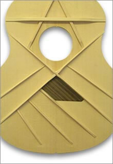

I found this pic on the Avalon Guitars blog. They say it is a pic of a Lowden. Two interesting things are: The direction of the grain in the bridge plate (a cross between tradition and Frank Ford's parallel grain plate.) And, the omission of the two finger braces for one long "semi-fan".
The X appears to be rather light and un-scalloped.

Aside from the obvious brace changes, this reminds me of a L-00 top you can see on James Burkett's website. I couldn't believe how lightly those old Gibson's were built. I hope Mario is watching. This goes in the notebook.

It seems like the bracing in the picture is exactly like th guitar patent idea that was discussed in an earlier post. Even the two "semi-fan" braces are drawn on the picture for the patent by Martin. Huh?
